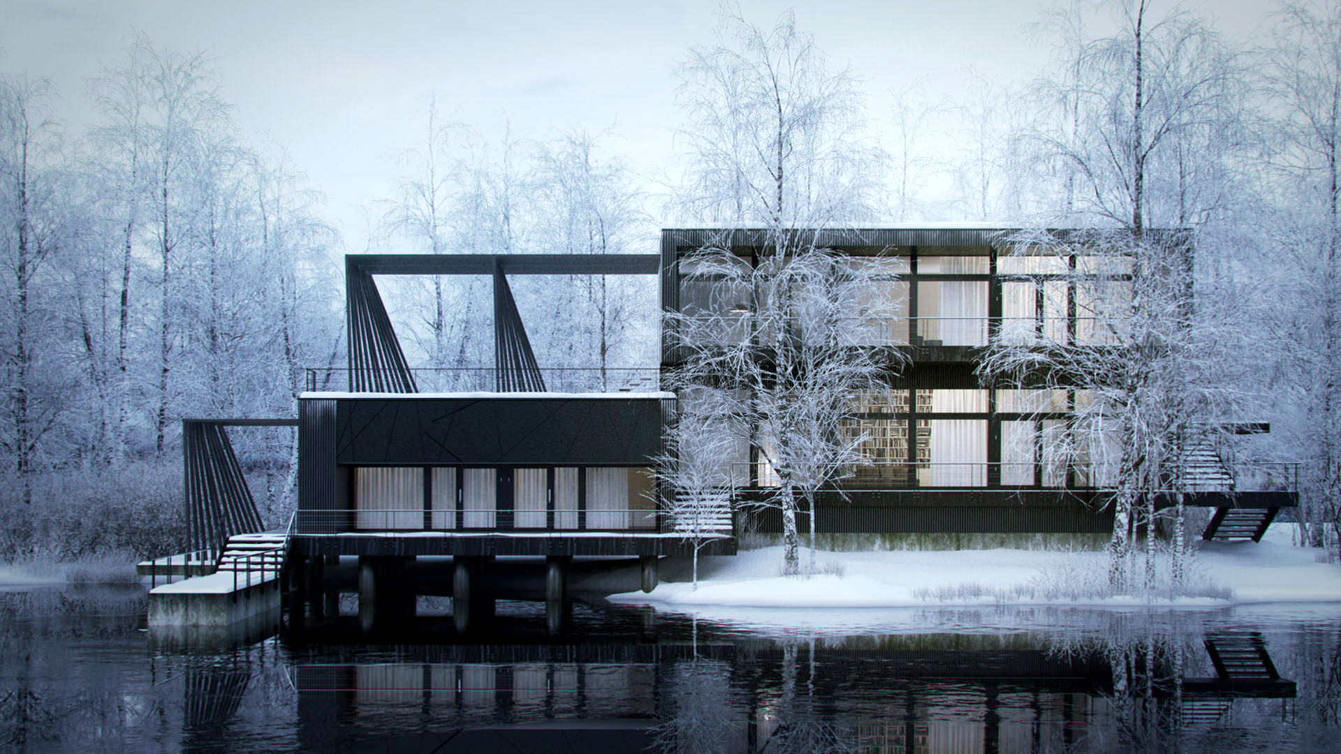

I found the Nordic House visuals by Héctor Javier Diez Valladares during my routine browse on Behance. My eye landed on it rather quickly and I could understand perfectly why it won first place in the First Latin-American CG Contest it was intended for. With snow being a rare treat for me I’m always drawn to such images, and this one had a great feel to it and so I wanted to know more and this article came to be. Enjoy!

The Nordic House visuals were done for a competition and I want to express my deepest appreciation to the organizers of “Primer Concurso Latinoamericano CG” (First Latin-American CG Contest). Special thanks to Eddy Guzmán for having the initiative and making this contest a reality. It is a real honor for me to have been selected as the first place winner from such a prestigious jury – Julio Lazarte, Juan Carlos Ramos, Thi Lima, Iván Guillén, Javi Martínez and Ricardo Ortiz.
Here are the images I created for this house :
nordic-house-final
74be9589fbad19cdf8b56b60127ec7b9
578db67657200b9c642f9cb799e404ad

Post Production
Starting with a RAW render…
nordic-house-raw
Overlay 40% opacity
nordic-house-post-01
Curves & Saturation 1
nordic-house-post-02
Curves & Saturation 2
nordic-house-post-03
Curves & Saturation 3, Chromatic aberration and Vignetting
nordic-house-final
I hope you enjoyed it and you might find it helpful in future projects.
