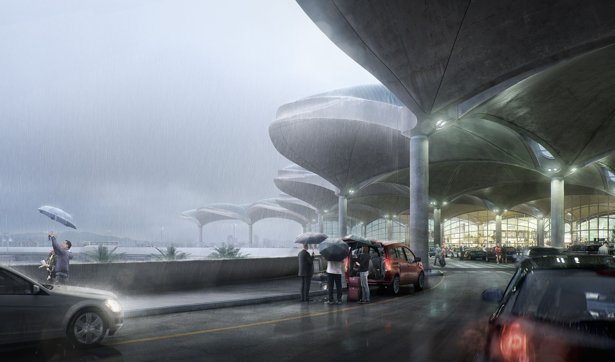

Marcin ‘NEB’ Jastrzebski’s ‘Queen Alia Airport’ visual, recreating the real deal designed by Foster + Partners in Amman, Jordan, awarded him with Best Visualization of the Week NO. 15/2016 for a remarkable CG remake modeled with Modo and Cinema4d, rendered with Corona Renderer and masterfully orchestrated for the final result in Photoshop. Follow this article as Marcin describes his process, focusing more on key principals then the technical aspects. Enjoy!

The Composition
From the beginning, I had a ready main concept for this image, but of course, a lot of elements can be determined during the whole creation process.
I decided to show the beautiful roofing shapes and monumental architecture but also, I wanted to show the open outside space to make a field for the rain effect. It needed to get the right balance in the final composition consistent with my ideas.
A camera is a basic tool which we use to show the architecture. For me, one of the initial questions is how to set the focal length. How deep I should distort the building shapes by using wide angle focal length or if I should avoid it and use more close to standard values or even a telelens.
In this case, I have set the camera focal length to 28mm for two reasons. Such as in real world 28mm for full frame digital cameras is quite nice wide angle setup. Firstly, I don’t need to distort too much the original organic roofing shapes because they are attractive in their own form. Secondly, to make a dynamic composition a wide angle helped a lot ( please look at the picture below) and additionally emphasize the roofing shapes in the top right part of the image. 28mm focal length was right to keep a good balance between those assumptions. In this way, I achieved nice roofing shapes and also could show enough outside space.
queen-alia-00015
I divided the main composition to a few areas and tried to predict the colors and details for them. First is the main cold color mood which gives the biggest influence on the entire image.
queen-alia-00016
The second is a light gradient under the roofing. It ensures nice light effect but also, following the darkness in the depth of the image ensures good conditions to emphasize the interior light.
queen-alia-00017
The interior space covers a small area of the whole image but for me, it’s important too. After all, it’s an airport! I used warm light for this part as an opposite to the cold main part. The small warm light part of the view focuses our attention quite effectively and enough by this way.
queen-alia-00018
Without overloading the composition, I added additional elements like cars and people carefully. The most important point are the people located beside the red car. I avoided the central position (in most cases it’s a composition mistake) and located them close to one of the important composition points which are consistent with basic photography rules.
queen-alia-00019
The first plan composition I connected mainly by three cars. It’s enough for the view. I was careful not to over burn the car lights. Bright light will focus our attention too much.
queen-alia-00020
In my opinion, dividing the entire composition to a few areas helps us keep the clear and distinct final effect. I mean that we can focus on main aspects of the view and move step by step to a more detailed effect on the way to the final image without loosing the main concept among a lot of creative decisions.

I added these people (assets from VIShopper in this case) in the left corner, acting as the ones looking at the sky… It’s an airport but putting an airplane in the sky would be too much for this composition. A subtle hint could do the trick too… who didn’t look up to the sky arriving at an airport, ha?

Finally, I made a little color correction to the final image in Lightroom and after that in Red Giant Looks plugin for After Effects. It was mainly the bloom effect, vignette especially for the bottom part of the image and right side of the roofing and chromatic aberration.
queen-alia-00033
