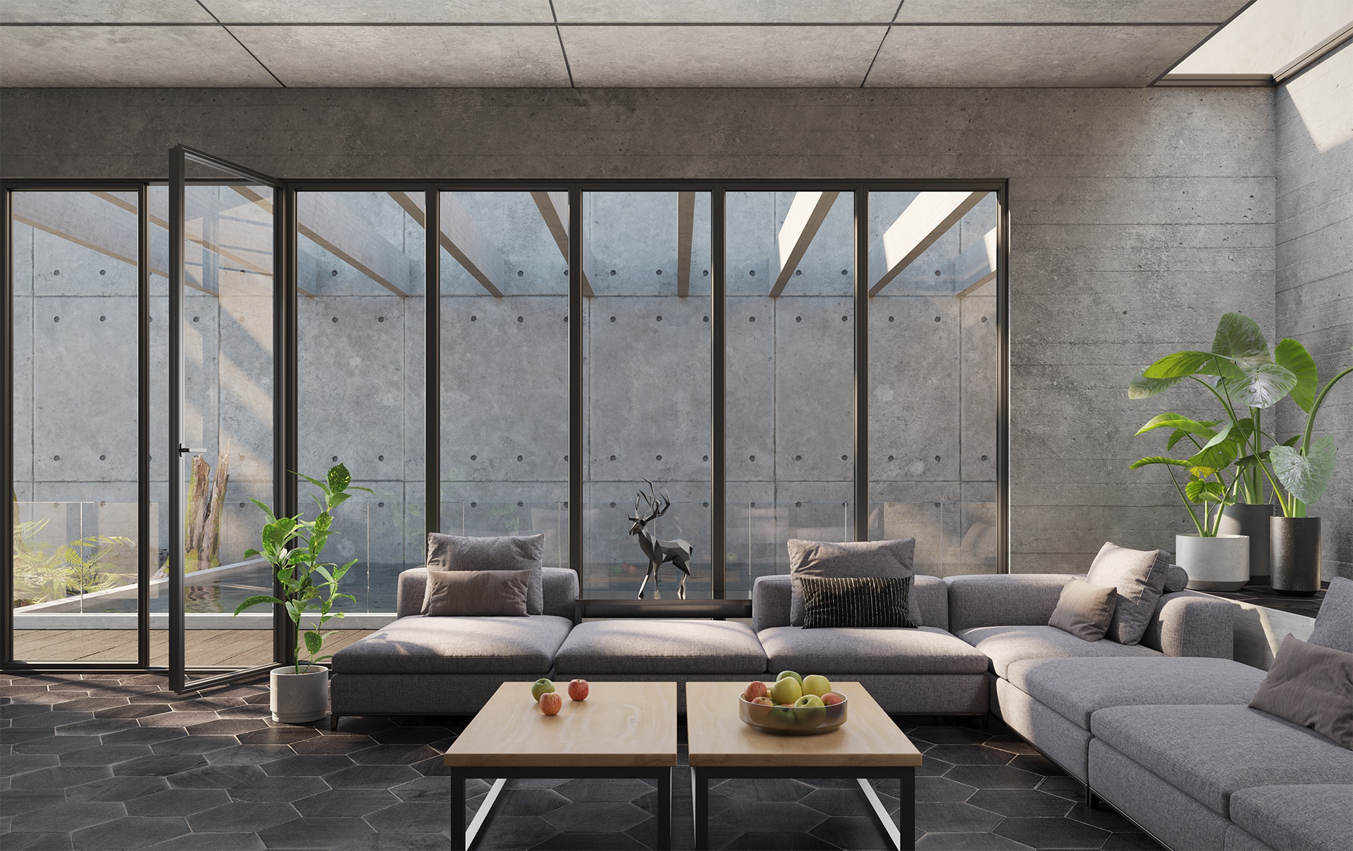

We’ll be creating a cool architectural interior using nothing but a bunch of planes and boxes, and several Megascans objects and surfaces.
The starting scene is a room looking out on a courtyard of sorts, using a central perspective. We have several large windows looking out, and a ceiling window, which should enable us to get some beautiful looking light in the scene.

All that’s left for us to do is sort out the foreground. I’ve selected one of the sofa models we have available in the studio, but feel free to pick your own.
The Megascans library contains a vast amount of fabric surfaces, so we’ll use some of those for our sofa.
I’ve also modeled two straightforward coffee tables, and with the same process from before, we can import some 3D fruits from the Megascans library to add some life to our tables.
To finish up our composition, I added a small deer sculpture for some added visual interest.
And that’s it. I hope this short breakdown shows you how easy it is to transform what is essentially a few boxes and planes to a finished ArchViz scene. Thanks for reading!
